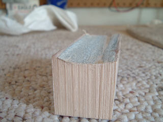

Here is a simple little tool someone shared with me: A concave block with sandpaper glued in.
